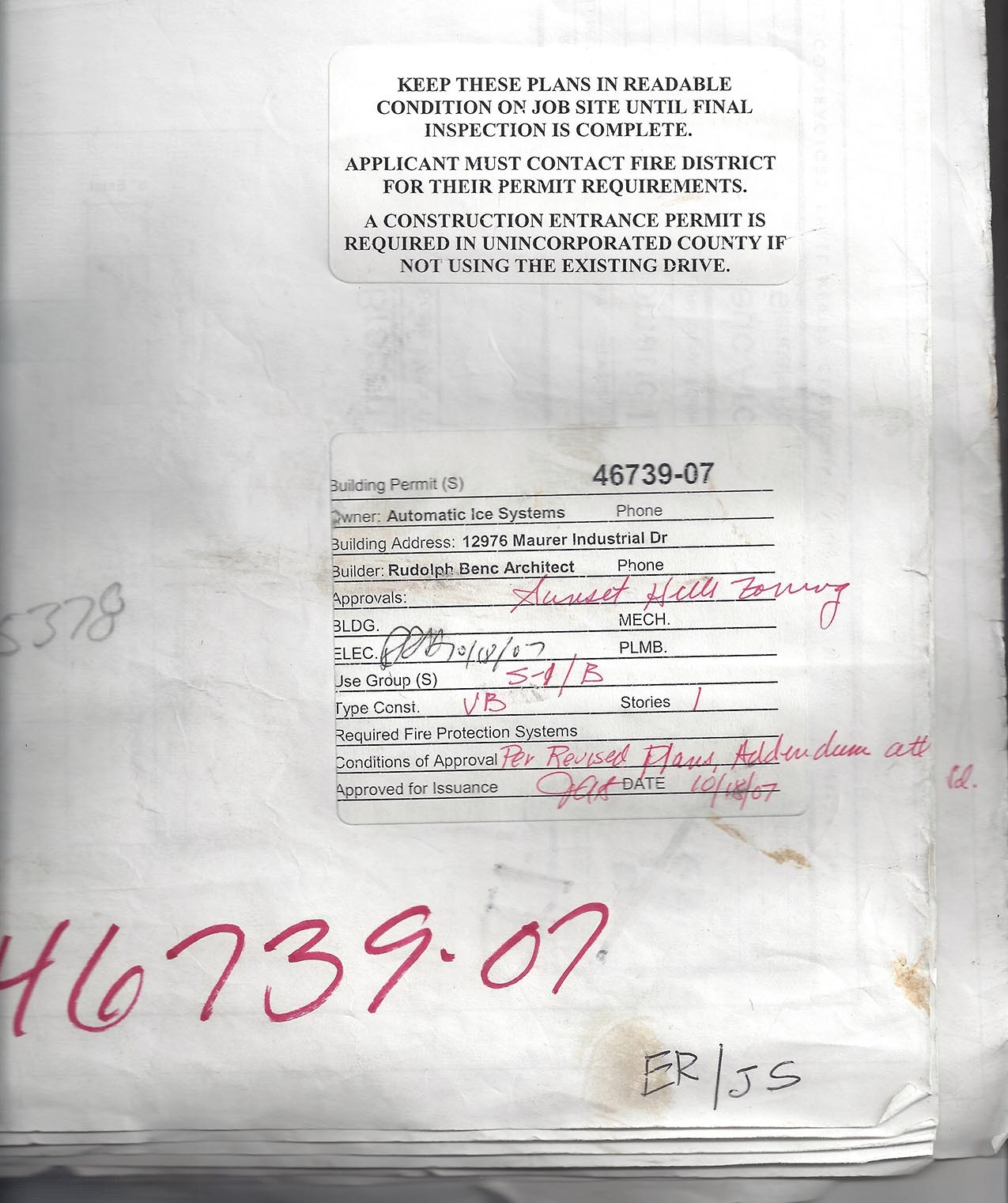

    Comments from the AHJ are easily addressed by making the revisions necessary, issuing copies of the new set containing revisions, and then submitting those copies to the AHJ for their stamp of approval and record. Happens all the time.
    Revision Stamp By AHJ
    Markings from the AHJ denoting that this is the set approved for construction.
    Attached is two images of markings an AHJ as left on a revised set indicating that this is the set approved for construction. As can be seen in the comments, a copy of these is to remain on site for reference during construction.

    And when changes or revisions are made over the course of the project and after permit?
    I rest my case.

    If the AHJ demands it, provide an addendum.
    Again, it's not that hard.
