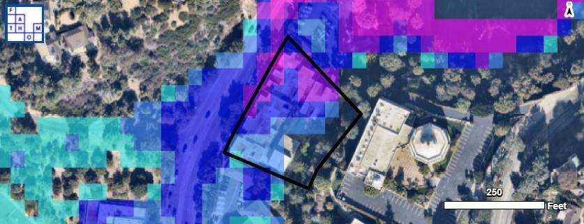

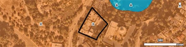

The PRA process starts with a hazard screening to identify which current natural hazards and future climate-related hazards pose the greatest threat to a subject property or asset. In many cases, current and future physical risks due to natural hazards and climate change are very localized, so risks are best assessed at the asset level. A minor difference in topography or location could significantly change the potential impacts from flooding, storm surge, sea level rise, wildfires, or other hazards. Importantly, thorough hazard screening pulls from multiple quality data sources. For example, current FEMA flood maps only address fluvial (riverine) flooding and are based on historic rather than current and future flood risks. Other sources, like Fathom’s global flood maps, cover all flooding risks, fluvial, pluvial (heavy rainfall runoff), and coastal flooding.
Showing only moderate risk of fluvial (riverine) floodingFEMA Flood Hazard Map; Showing only moderate risk of fluvial (riverine) flooding. Courtesy of RiskFootprint.
Showing significant risk of 1 to 4 meters of flooding from heavy rainfall
1000-year Interval Pluvial Flood Map: Showing significant risk of 1 to 4 meters of flooding from heavy rainfall. Courtesy of RiskFootprint.
