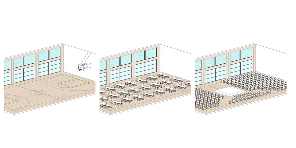

Adaptable buildings offer flexibility for multiple functions and reconfigurations. Interchangeability, the ability to reprogram a space designed for one planned function to different uses, creates spaces that can be used in multiple ways over their service life. Pre-planning a building for future interchangeability may suggest a standardized set of rooms used for a variety of different functions, a concept known as ‘Long-Life, Loose Fit’. The term was first used by the architect John Weeks who developed the Duffle Coat Theory of space planning (Architects’ Journal, July 7, 1960):
‘In order to get maximum flexibility within a (hospital) department it is necessary to provide rooms which fit around the activities which are to be carried out in them like a duffle coat.  The duffle coat, provided by the Navy for its officers, was not a tailor-made garment.  A few sizes were made and these were related to the known sizes of sailors so that it was usually possible to find one that would fit reasonably, and keep the sailor quite snug.’[i]
Weeks and Llewelyn Davies discovered that between 50-65 percent of the rooms in hospitals were less than 19 m2 (200 SF) in area, and most between 9-14 m2 (100-150 SF).  These rooms were regularly reprogrammed, causing extended demolition and reconstruction to fit the spaces to their purpose. Weeks contended that flexibility in hospitals improves when there is greater interchangeability between activities and spaces, and that a small number of distinct room sizes improves interchangeability.  A room of 14 m2 (150 SF room) allows patient examination, storage, doctor’s office, waiting area, and a host of other functions depending on the space’s proximity to other equipment or functions, with only minor renovations necessary to accommodate various uses over the life of the structure.
There are many other ways an architect can promote adaptability:
·         Consider alternative future uses early in design. For example, when converting office space to residential use, adequate interstitial space to run additional power, piping, and ductwork is critical. Leaving space for vertical chases and horizontal plenums may have immediate and long-term payback.
·         In building typologies with rapidly changing programmes, leave 5% of space undefined, for use as collaboration space, open work areas, or expansion. This gives building users the freedom to manipulate the space to meet daily demands or a seasonal schedule.
·         Design ‘soft spaces’ for administration, lounges, and storage adjacent to areas that anticipate growth. Consider where to accommodate these functions if they must be relocated.
·         Plan future expansion areas so they do not displace other functions.  Design structural bracing and frames at end walls to allow for horizontal expansions. In dense urban environments, consider the potential for vertical expansion and plan foundations and structural frame to support future growth.
