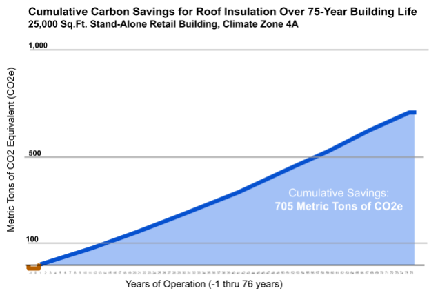

Below demonstrates the cumulative carbon savings for a 75-year building life, as outlined in the polyiso EPD. In the example, the roof insulation begins at R-30 and increases every 20 years by R-10, corresponding with periodic roof membrane replacement. In this analysis, the initial insulation product’s embodied carbon, replacement embodied carbon, and end-of-life disposal are considered. What is clear is that shortly after the building becomes operational, the embodied carbon of the materials is dwarfed in comparison to the savings provided by the use of the insulation product. The increased roof insulation ultimately saves a net of 705 metric tons of carbon over the 75-year life of the building.
