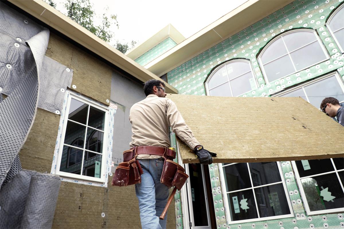

Exterior walls are especially vulnerable to wildfire flames, radiant heat, and conductive heat, all of which can ignite combustible materials located on or within wall assemblies. In this context, the fire performance of exterior walls is determined largely by the materials chosen. Selecting noncombustible options such as fiber cement, cement-based stucco, masonry, stone, and metal greatly increases protection against ignition, flame penetration, and flame spread. The addition of continuous mineral wool insulation can further enhance this level of fire resistance. To ensure that exterior walls perform reliably under wildfire exposure, it is essential to conduct fire resistance testing from both the interior and exterior sides, particularly when combustible materials are involved.

Addressing the fire resilience of existing homes in wildfire-prone areas is also essential for community safety. Upgrading older buildings provides a valuable opportunity to implement fire-hardening measures while improving energy efficiency. Recent wildfire events show that advanced strategies, such as replacing combustible exterior wall coverings with noncombustible materials, installing ember-resistant vents, and establishing defensible space, are increasingly necessary. Retrofitting with fire-resistant technologies, like mineral wool insulation and continuous air barriers, enhances both fire performance and building durability, while also reducing energy use and improving indoor air quality. Applying these upgrades to accessory structures such as garages, sheds, and fences further reduces overall fire risk. The effectiveness of these efforts is clear: After the 2018 Camp Fire in California, nearly 60% of buildings constructed to modern codes survived, versus only 21% built before stricter codes. These results highlight the value of adopting comprehensive hardening measures for all existing homes.
