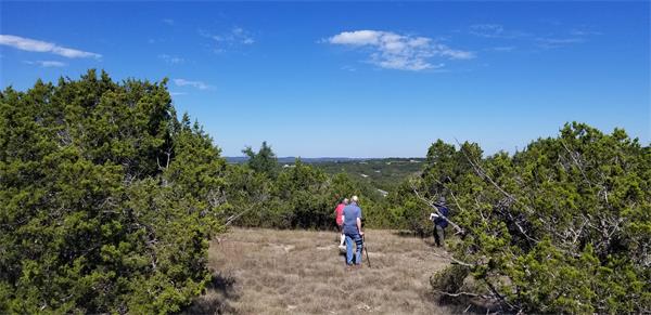

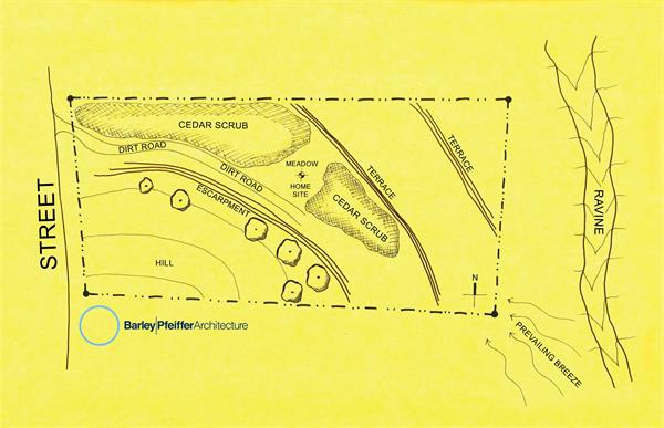

One fundamental of their approach is getting the site planning right. The best way to do this is simple: Go out on site with some sketch paper. “I look for the sky,” said Alan K. Barley, AIA, principal. What he means by this is that he looks for places where the land is “scarred or torn up” so they can avoid removing trees and other vegetation. Leaving more of the nature intact doesn’t just preserve beauty, it also helps with wildfire management.
Bringing clients along on the site visit helps involve them in the process from the very start. The firm believes their role is not just to design houses but also to guide their clients. Involvement helps clients develop a sense of ownership. Photo courtesy of Barley | Pfeiffer Architecture.
In their experience, the place where people naturally gather is usually an ideal spot for the home. In this case, everyone gravitated to an opening between two hills covered in cedar scrub. The spot provides protection, showcases views, and allows for the home to be oriented for passive strategies, including natural cooling, enhanced natural ventilation, daylight harvesting, and passive heating.

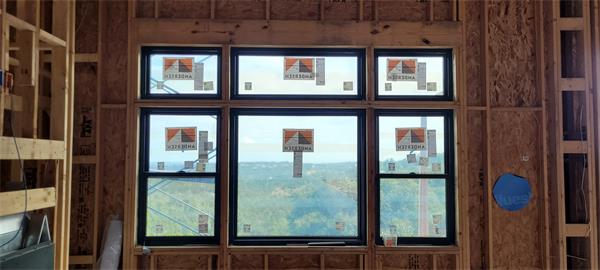

Similarly, they thought carefully about materials selection, opting for durable materials that are equipped for the climate and will last for many years. They chose Andersen 100 Series windows, which are comparable in price to vinyl windows but much more thermally stable and rot resistant. They chose a metal roof and fiber cement siding because both are non-combustible. While some of these materials have higher upfront costs, their performance, minimal maintenance requirements, and longevity make them cost effective in the long run.
In the open concept living room, a large window combination made of picture and single-hung windows from the Andersen 100 Series product line makes the most of the breezes and views. Photo courtesy of Barley | Pfeiffer Architecture.
