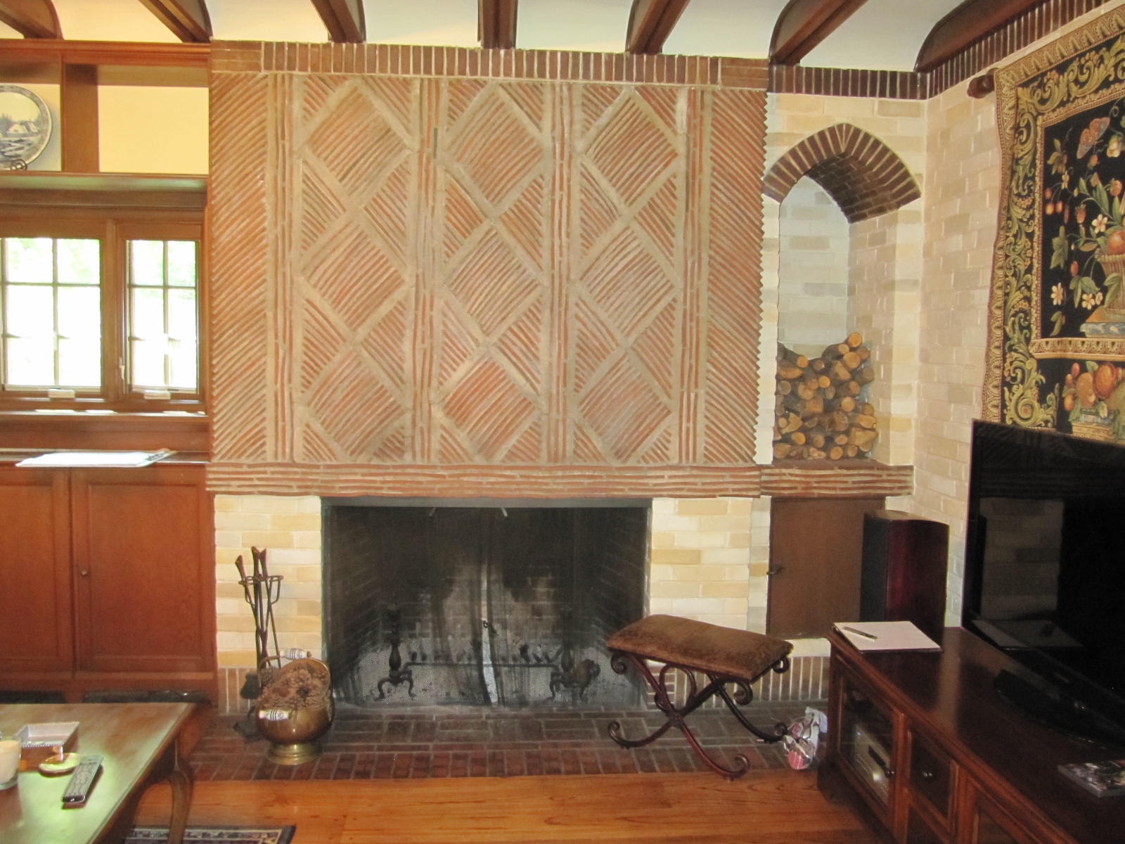

    I have seen similar details in the Country Club Historic Neighborhood in Denver. This from our Design Review application:
    "Originally built for Genevieve Kassler and Sydney L. Brock, Jr., this 1928 home was designed by Merrill & Burnham Hoyt in the French Normandy style".
    Happy to share my research on the project. Attached are a few photos and good luck w/ the save.
