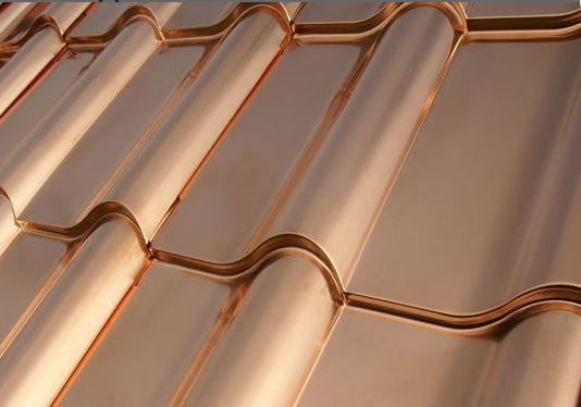

    What I’ve found what best replicates what you’ve described is The Copper Mediterranean Tile from Future Roof Roofing Systems (https://futureroof.com/copper-roof), unfortunately on their website they don’t have any information about the profiles w x d x h, but I’m sure one of their people could get you that information. You indicated that you hadn’t been able to find any thing that replicated the  barrel-flat pattern of the originals, but hopefully this is close to what you need.

    I would contact wfnorman.com.  They may be able to custom replicate the roof tile within your budget.
