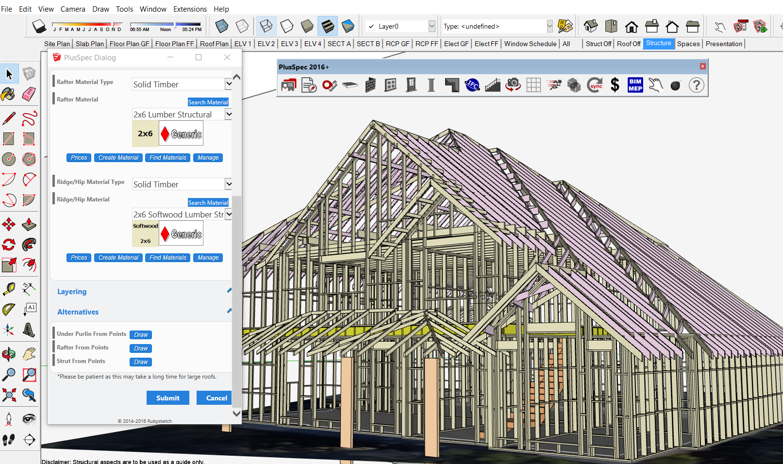

    Sketchup has the freeform modelling nailed and gives you the freedom to design and communicate with clients, engineers, builders and manufacturers,  which I believe is its true benefit, however you can find yourself spending a lot of time editing, changing components, setting up scenes and groups when you want to start modifying the model at the time of creating construction documents.
    If you like using Sketchup yet simply wanted to increase the ability to change the model parametrically like ArchiCad and Revit, you could look at some of the extensions available as there are many.
    BIM/VDC in Sketchup Pro is a reality, the learning curve is shallow and the output can be amazing. If you want to move to stage 2 and really get into BIM in Sketchup the opportunity is there and viable.  There are hundreds of 3D CAD tools on the market, the key is finding one that suits you best. I did this model (4 hours draw time) in Sketchup and with the BIM Plugin PlusSpec. You can now work more efficiently with Sketchup and have an organised model without having make groups, components, or assign IFC categories.
    To be transparent I do work for RubySketch, yet I also work with Revit users. Many use PlusSpec and Revit in their day to day activities:
    1. Residential & multi residential BIM/VDC in Sketchup Pro with PlusSpec
    2.  Larger commercial projects Over 10 million EG hospitals in Revit.
