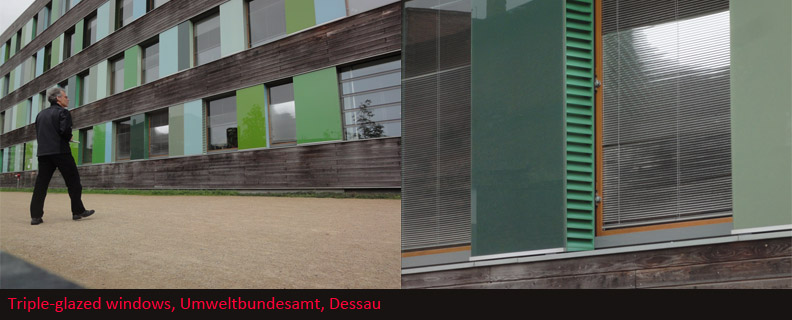

    Newer buildings in Germany use many strategies to beef up their thermal resistance to outdoor temperature swings. These include both colored panels and intensive thermal bridging strategies. In Dessau, we saw an extensively daylit office for a governmental environmental agency with insulated panels and windows mixed together.
    From a report on the façade optimization used in this building:
    "The window strip is divided into transparent and colour areas. This zone has windows that can be opened, opaque pivot-opening elements for night ventilation, and glass-covered wall elements. The windows (U value 1.2 W/m²K) have another single layer of glazing on the outside, with the sun protection fitted behind this. 35% of the exterior facade is glazed. The interior facades facing onto the atrium and forum also consist of wooden elements. The windows facing onto the atrium (U value 1.3 W/m²K) have glare protection fitted on the inside." Try this link for more information, although the link is tricky and may appear not to work at first: http://www.enob.info/en/new-buildings/project/details/new-building-for-the-german-federal-environment-agency-in-dessau/.

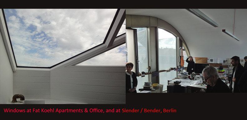

    These very thick, well-insulated panels are used also in a very small, mixed-use office that we saw in Berlin, the Slender / Bender, by deadline Architekten. These panels appear as opaque wall panels when not open. The particular panel that is used in the main hall at Slender / Bender is approximately 6" thick!
    There is a playfulness among some new construction in Berlin. In use of windows, we saw some windows wrapping onto roofs to become skylights, holes cut out of interior walls for views, and even decorative curtains installed outside of an apartment, rather than inside.
