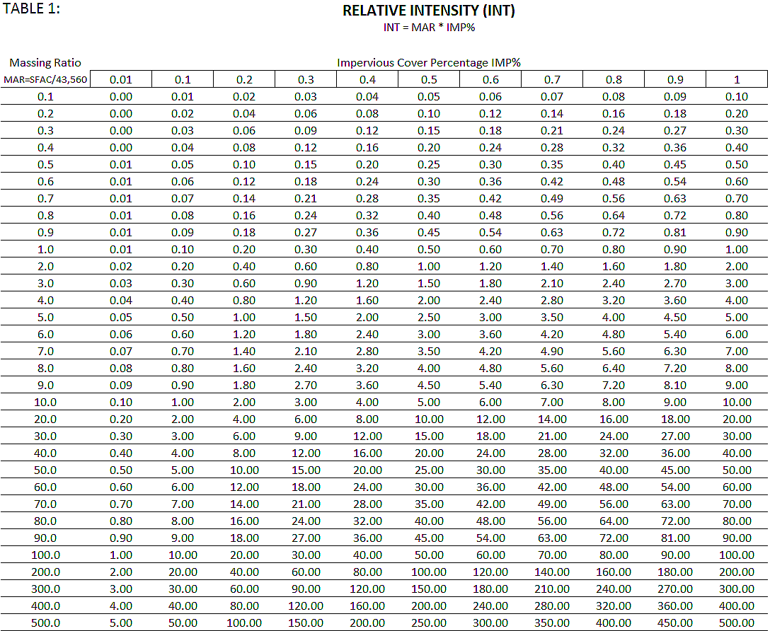

    The Theory of Relative Intensity
    A range of potential building mass values has been placed along the y-axis of Table 1, but the ratios do not indicate the impact of related two-dimensional pavement. Impervious cover ratios are represented in ten percent increments of buildable land area along the x-axis to complete the matrix. When an impervious cover percentage is multiplied by a massing ratio, the result is a level of intensity within a given buildable land area (BLA). Table 1 presents the entire range of shelter intensity options available to planners, architects, and designers in a single table. The fact that a value is in the upper left hand quadrant of Table 1 does not automatically mean that it is desirable, however. Table 1 simply defines the entire spectrum, and many options are undesirable. The challenge is to measure, evaluate, identify, and locate existing success and failure within the table.

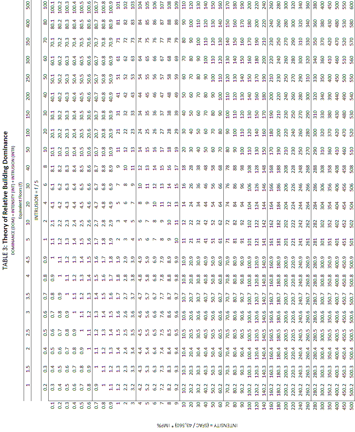

    Table 3 has been created to illustrate the spectrum of potential building dominance options. Intensity options are arranged along the y-axis and intrusion options are arranged along the x-axis. Adding the two options produces a matrix of dominance values that represent the spectrum of design options available, and not all are desirable. The challenge is the same as that presented by the intensity matrix in Table 1. Existing success and failure must be measured, evaluated, identified, and located in the table.

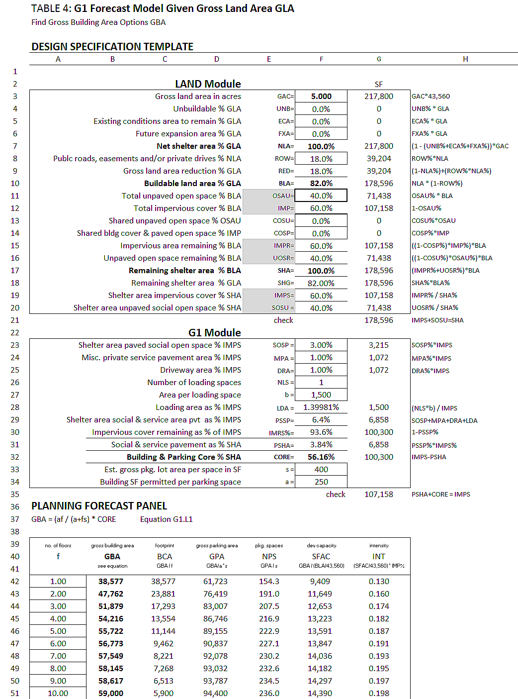

    Up to this point the discussion has focused on the measurement of existing conditions. The objective, however, is to learn from these conditions; to repeat success; and to avoid failure. This means that we must be able to use the knowledge gained to lead future policy, strategy, tactics, and performance. Table 4 is included to explain how this can be accomplished using the G1 Design Category as an example.
    The G1 Category includes all buildings with surface parking around, but not under the building. It seems to be the most popular shelter category in use today, and is occupied by a wide range of activities with an equally wide range of economic potential. The purpose of this example is to demonstrate how shelter capacity options for a given land area can be accurately predicted. This forecasting potential is the key to strategic city design evaluation and decisions that can be specified with the item values adopted in a design category forecast model.
    In other words, shelter category and capacity decisions come first. They establish the composition and context of an urban pattern that must be designed to protect our quality of life. Occupancy determines the economic potential of the shelter resource provided.
    Gross land area is given in cell F3 of Table 4 and shelter capacity options (GBA) are predicted in Column B of the Planning Forecast Panel based on the building height alternatives in Column A. The values entered in the boxes of the table represent the design decisions that were correlated to produce the forecast. This template should make it clear that a single value cannot hope to lead to the results predicted.
    A change to any value in any box of the template would produce a new forecast. The values predicted in Columns C-G of the Planning Forecast Panel are functions of the shelter capacity predictions in Column B. They are a small sampling to the predictions that can be made once the shelter capacity options in Column B can be forecast. For instance, construction cost, population, traffic generation, and the economic implications of occupant activity are just a few of the predictions that are a function of the square foot options forecast in Column B of the Planning Forecast Panel.
    The values entered in the template specification boxes of Table 4 represent a definition of human scale. There are 15 specification boxes and 10 building height alternatives that can be evaluated for a total of 25 optional design decisions. Measured values from an existing project could also be entered in these boxes for evaluation. The intensity levels calculated in Column G of the Planning Forecast Panel present the implications associated with these decisions. They are like blood pressure readings without a frame of reference, however. The condition of the patient cannot be placed in perspective.
    At the present time Table 4 represents potential. It is not an answer but part of a vocabulary and language that can be used to search for graduated levels within a human scale that will protect our quality and source of life. I won’t discuss Table 4 and its design category companions in greater detail because they are covered in my new book, The Science of City Design. It is available in e-book and paperback from Amazon.com. The book is my attempt to expose the potential to define human scale in terms that can define past decisions and lead to a symbiotic future.
