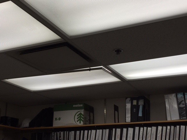

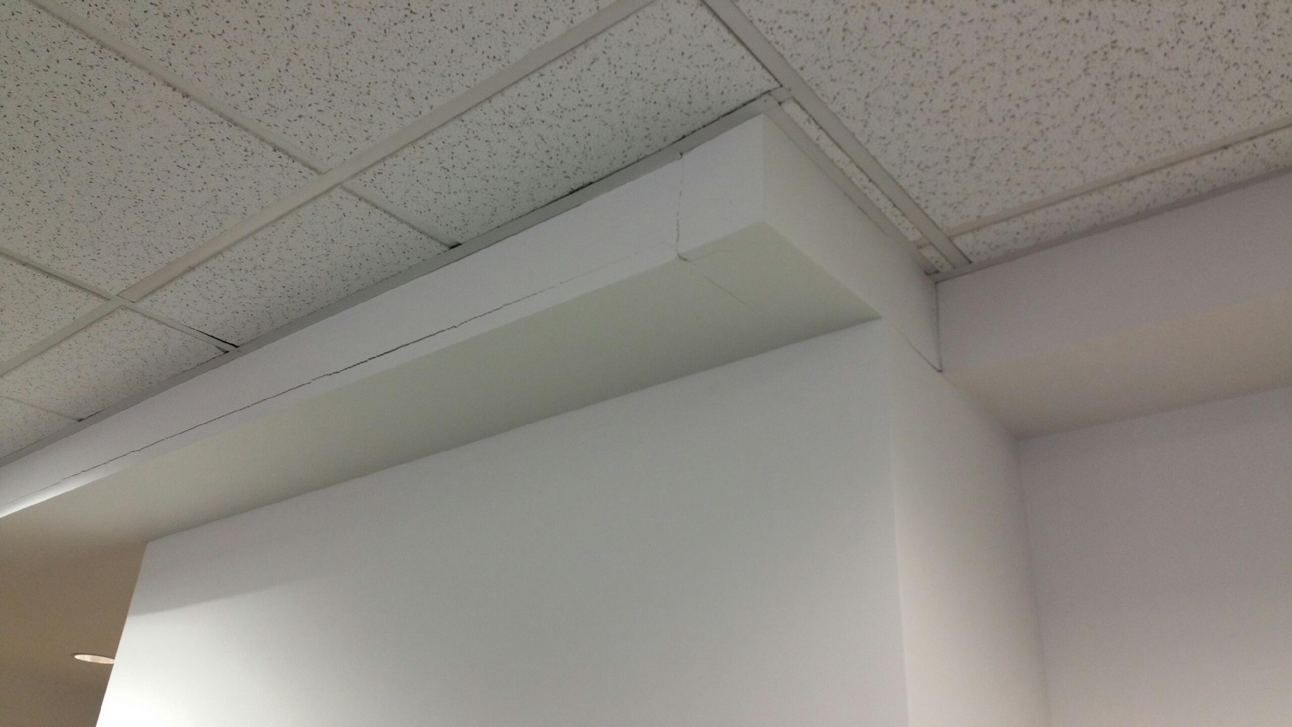

    A more reliable method I have discovered is to observe ceiling grids on upper floors.  The tracks nearest and perpendicular to the wall tell the tale of deflection.  The track attached to the wall is essentially supported by the floor structure below, and the parallel grids are most often supported from the roof structure above. The perpendicular track will tilt at an angle as seen in the photo below. The severity of the angle is directly related to the roof load. It beats climbing on a snowy roof anyway.  If the structure is visible and accessible from underneath, hanging a plumb bob can track deflection. Remember even though deflection can be visible, shear stress is also present and very hard to detect other than by calculation.
    I received an email from an EH&S colleague at another Biotech company who had recently closed a facility nearby with some photos. It was deflection causing damage to an overhead soffit detail (below)

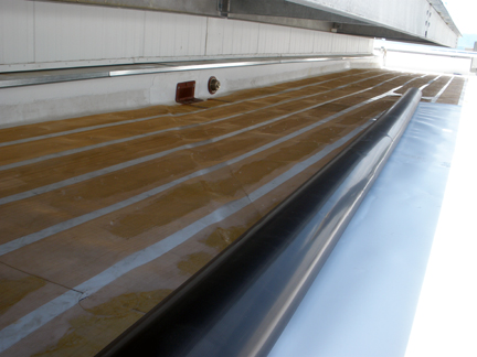

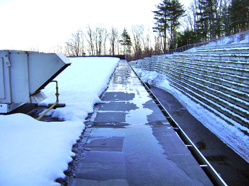

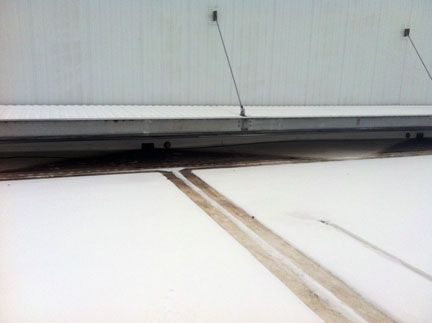

    We have had clients that could not for some reason or another restructure the building to provide for additional snow load requirements and have specified to de-ice the roof and drain system to get the weight off, or provide serviceable paths. I thought this thread might find these projects interesting for this topic.
    Under a membrane around mechanical equipment - Rhode Island School
    Providing drainage and snow load protection - Bowling Green Ohio
    Snow Load Protection after roof collapse - Snoqualmie Pass Washington
    Before
    After
    This next one is a before, during installation and the performance after in Richmond UT at a food plant facility for Pep Farms
    Ice Problem
    Low voltage heating element under the membrane
    No more ice and a walkway is provided

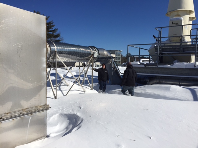

    I probably should mention that we have a robust snow shoveling contract in place every season that includes roof shoveling in order to clear mechanical equipment and maintain access.  This contract ensures that we have the resources in place in the event that loading relief is required. I have added a few improvements this year to the roof shoveling program that included dedicated shovels made out of plastic  with a 2" radius on each edge and detailed plans of pathways, drains and equipment. The shoveling specs is for accumulation of 6" or more with a minimum 6" of snow to remain on the roof walkways, a shovel should never be within 6" of the membrane.
    We had another storm over the weekend that dumped an additional foot of light snow but with a lot of wind and drifting. The wind has cleared much of the accumulation and the snow is still very light and dry. I did a brief walking tour on the upper floor and noticed a light fixture opening. The occupant hadn't noticed if it was a recent defect or not so it has been repaired and will be monitored.

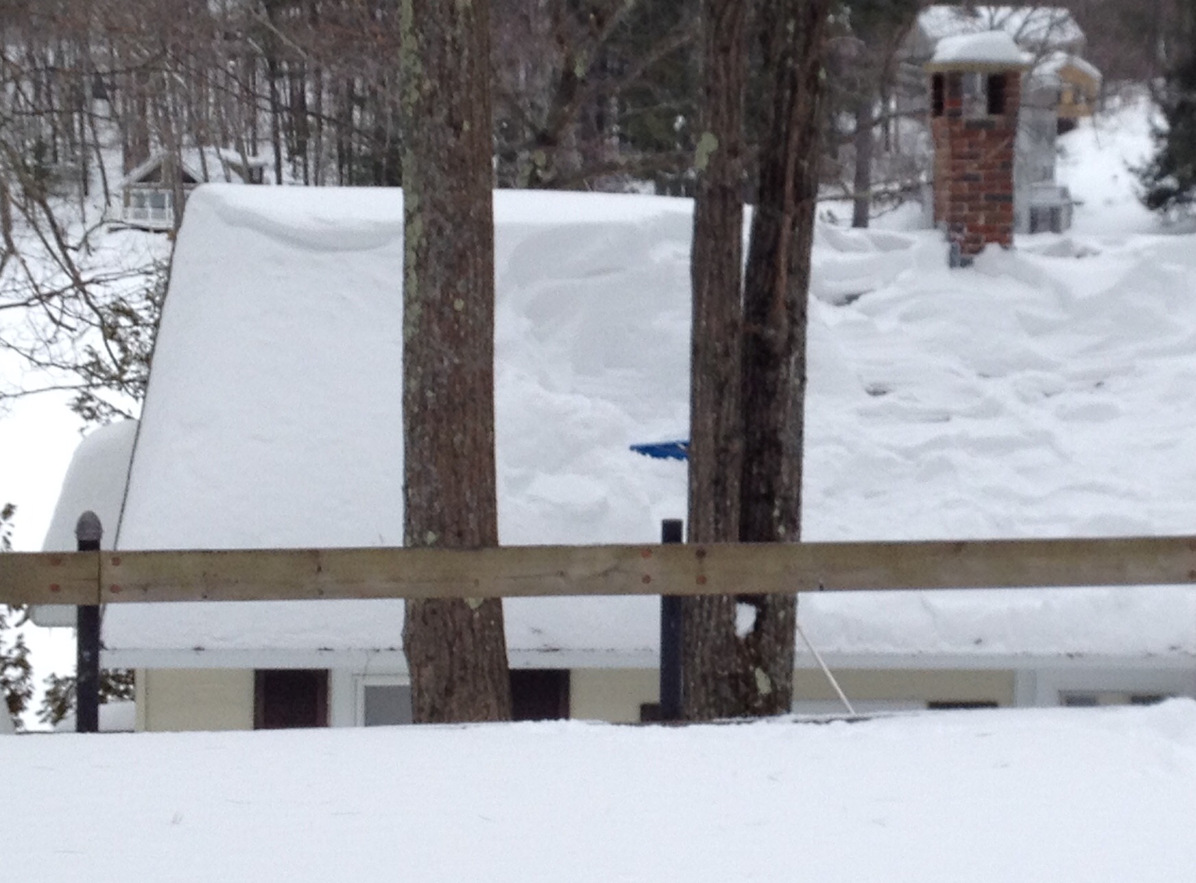

    A personal note, I strapped on snowshoes and checked on the summer cabin this weekend prior to the blizzard. I noticed one of my neighbors had at least a 6' drift which I removed with my roof rake. Here is what that looked like, it was more like chiseling limestone than snow. At first I thought about walking but my conscience did the math.  The wind has been  strong and it pushed all of the snow on this steeply pitched roof from the windward side to the leeward side. The prediction for this Sunday is wet stuff, now it gets interesting.
