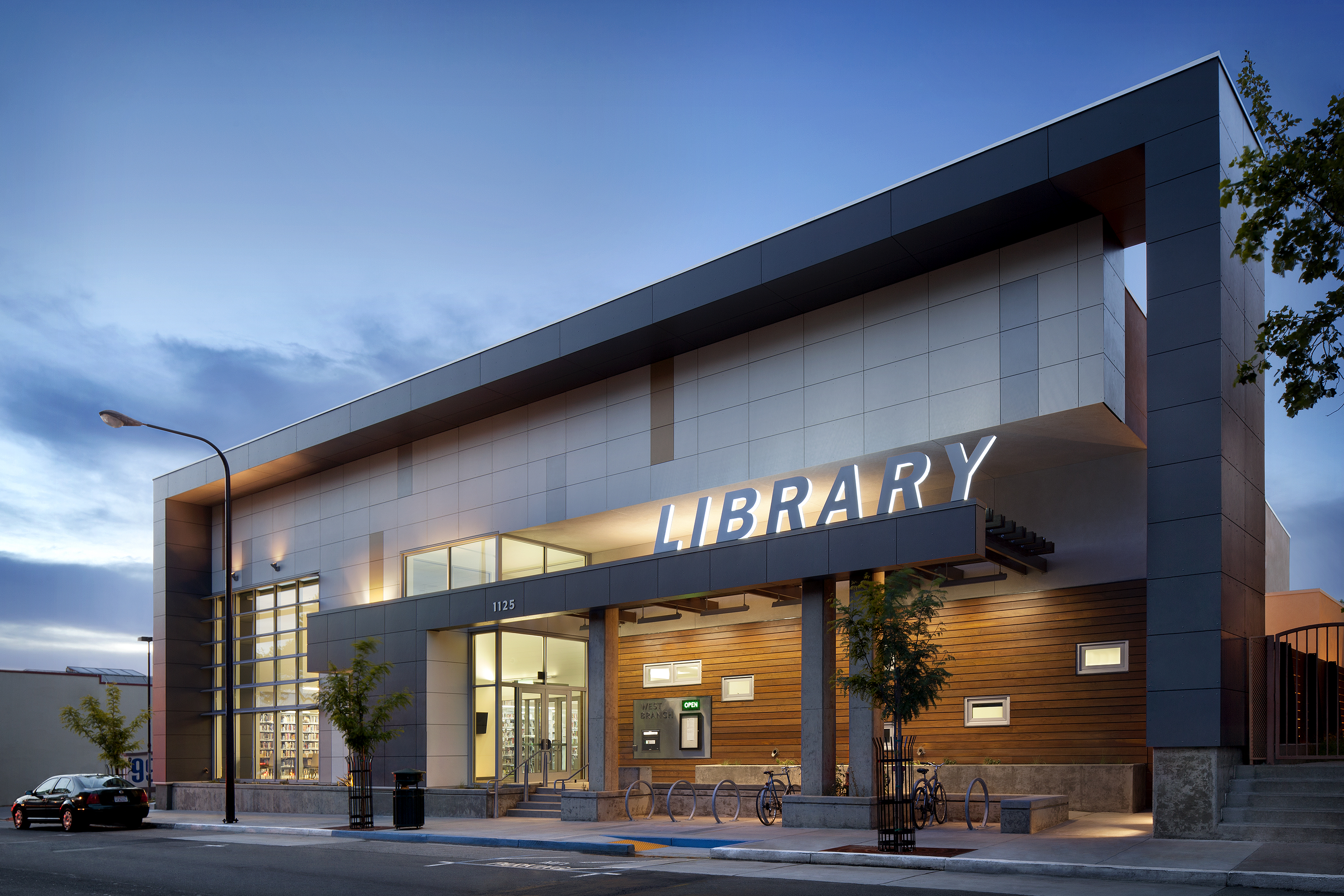

West Branch of the Berkeley Library
by Harley Ellis Devereaux with Roberts and Associates, Miniscule Lighting, Tipping Mar, Moran Engineering, Timmons Design, Kitchel CEM, Bruning & Associates, Smith, Fause & McDonald.
The team’s cites these lessons learned: “While CFD and energy models helped to develop the design, further modeling during construction enabled a better understanding of how specific systems would function. ... The design intent requires proper documentation where design/build systems like photovoltaics are concerned to reduce schedule delays and cost over-runs. It is critical to minimize late changes during construction, as these result in a domino effect on other integrated systems.”

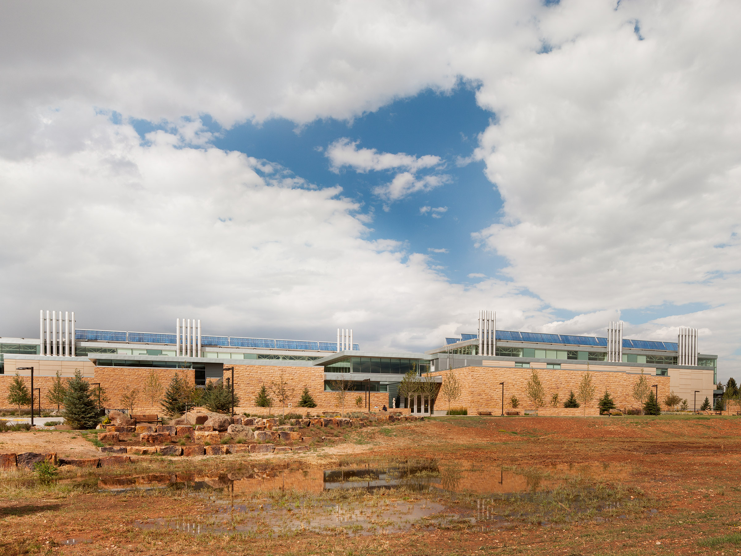

University of Wyoming Visual Arts Facility
by Hacker with Malone Belton & Able PC.
This submittal notes that “Both the owner and design team are sharing our experience of designing and constructing this facility—and the philosophies behind its design—with building users through a building dashboard. Measurement and verification of the project’s energy conservation strategies are supported by metering to provide concrete real-time data.” This team is clearly still engaged with the owner/client long after occupancy, a departure from conventional engagement (that may well merit study and emulation).
