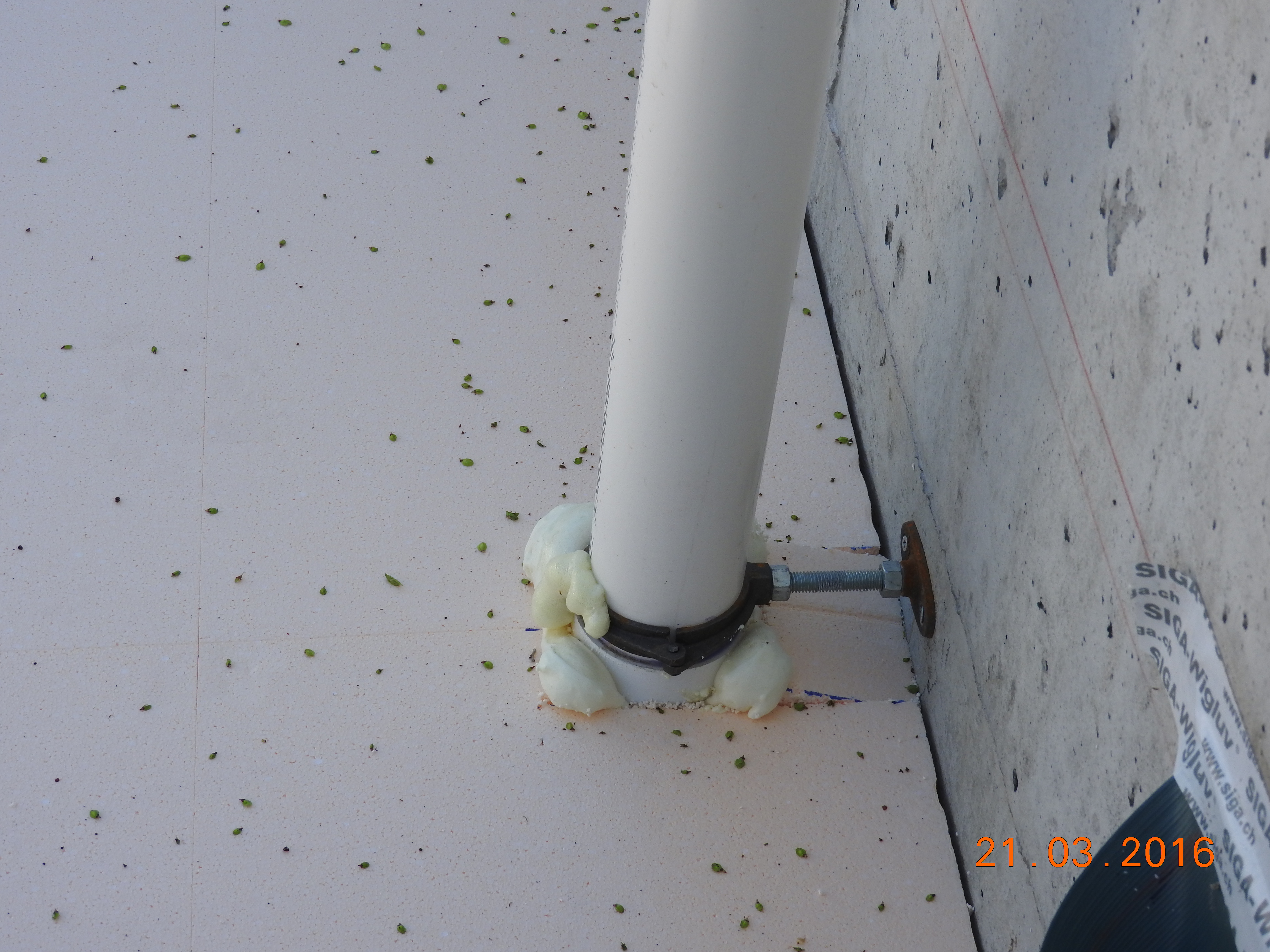

Any penetrations in the insulation are sealed with spray foam.

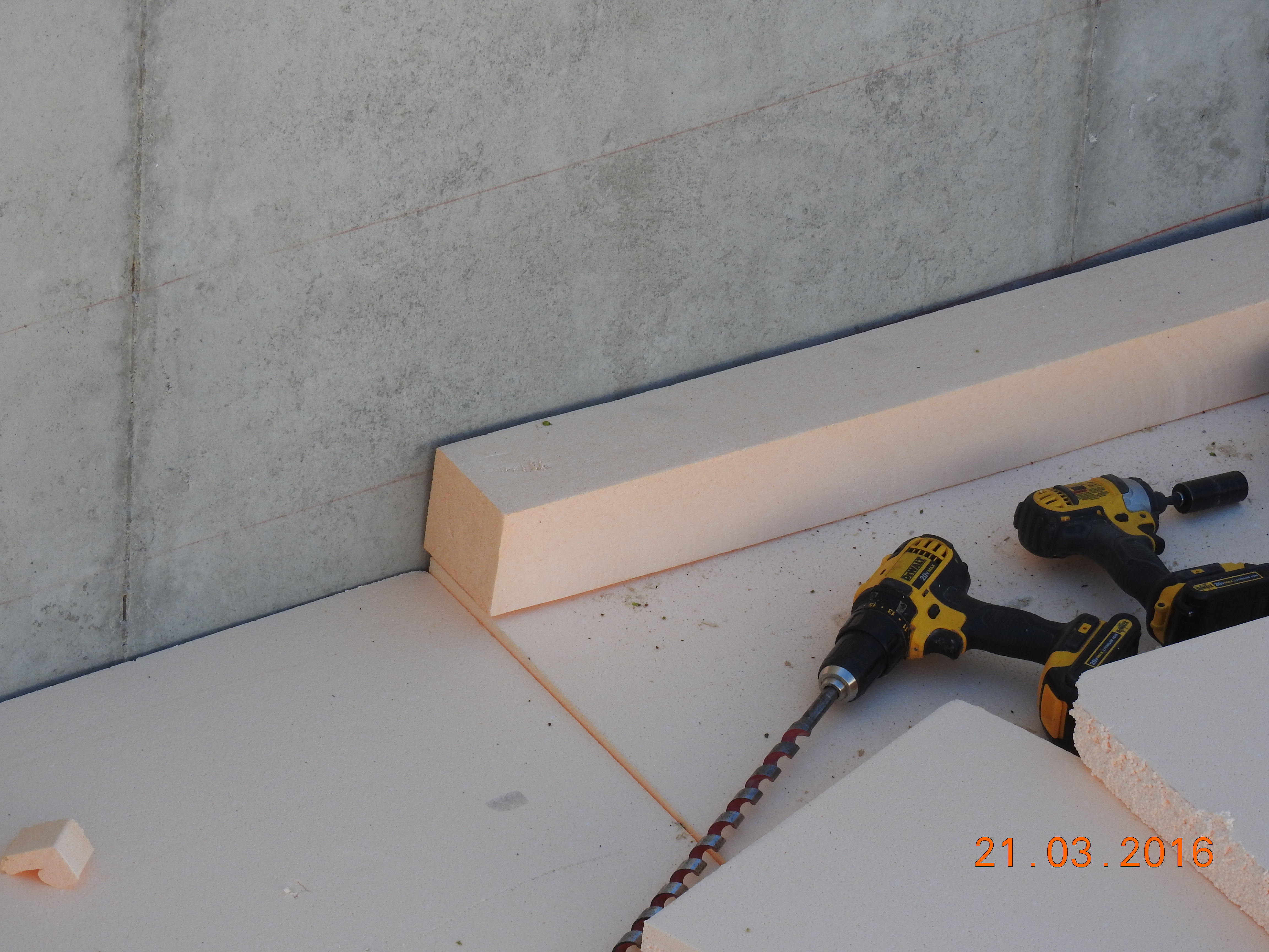

Four inches of insulation rated to 40PSI was used.
The insulation separates the slab from the foundation wall, allowing for thermal expansion and/or movement.

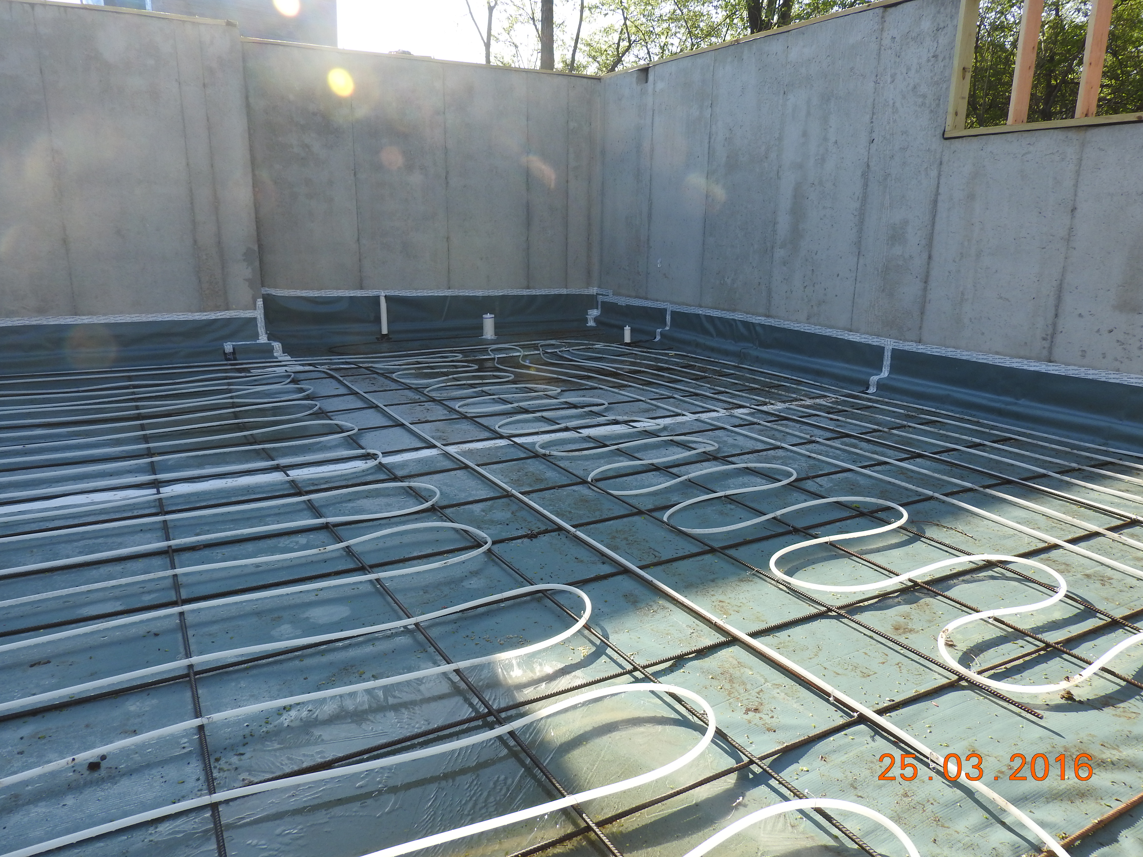

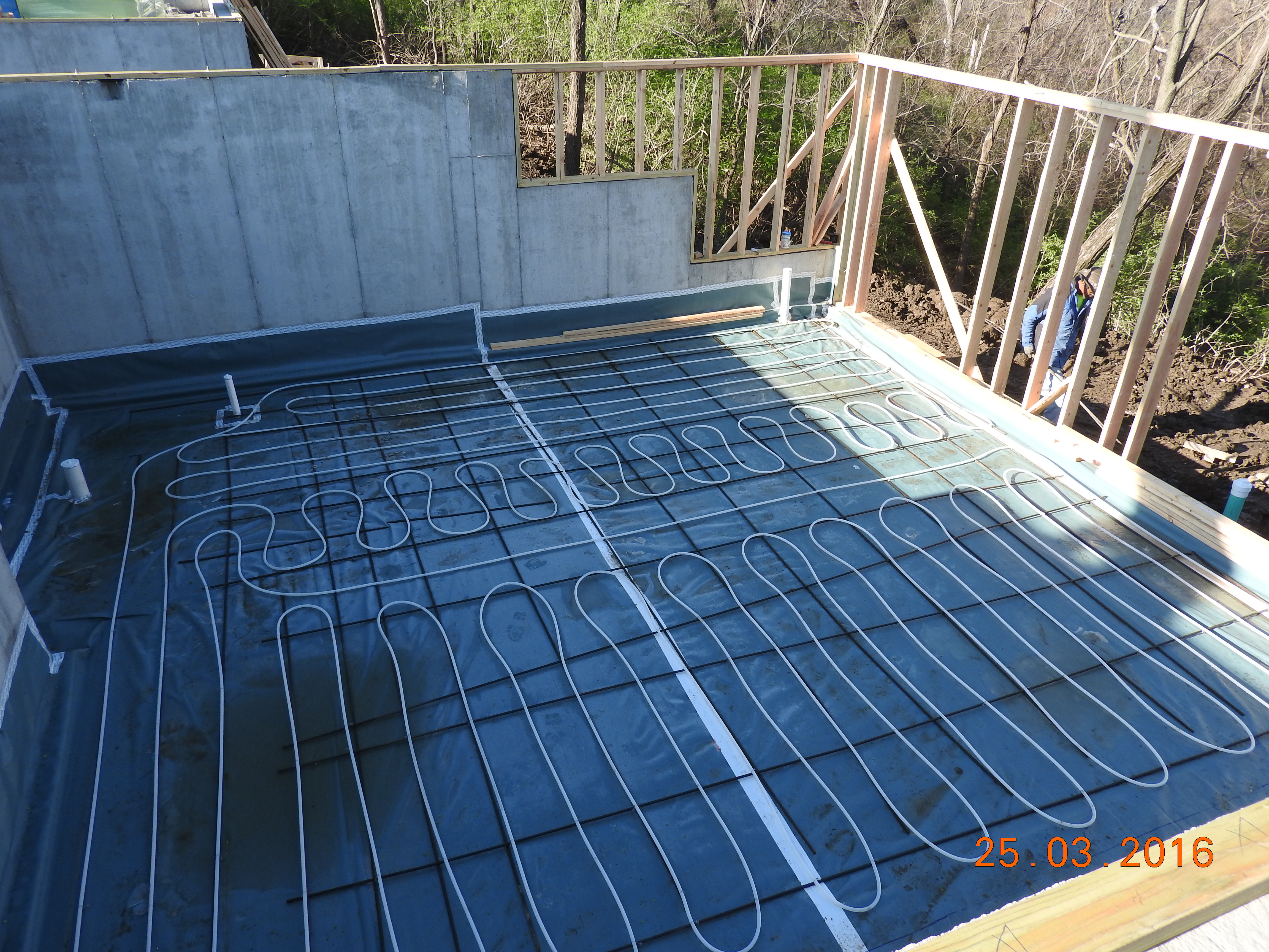

A 15 millimeter vapor barrier is installed over the insulation and sealed to the foundation wall with adhesive tape.
The rebar and radiant floor system are installed over the vapor barrier.

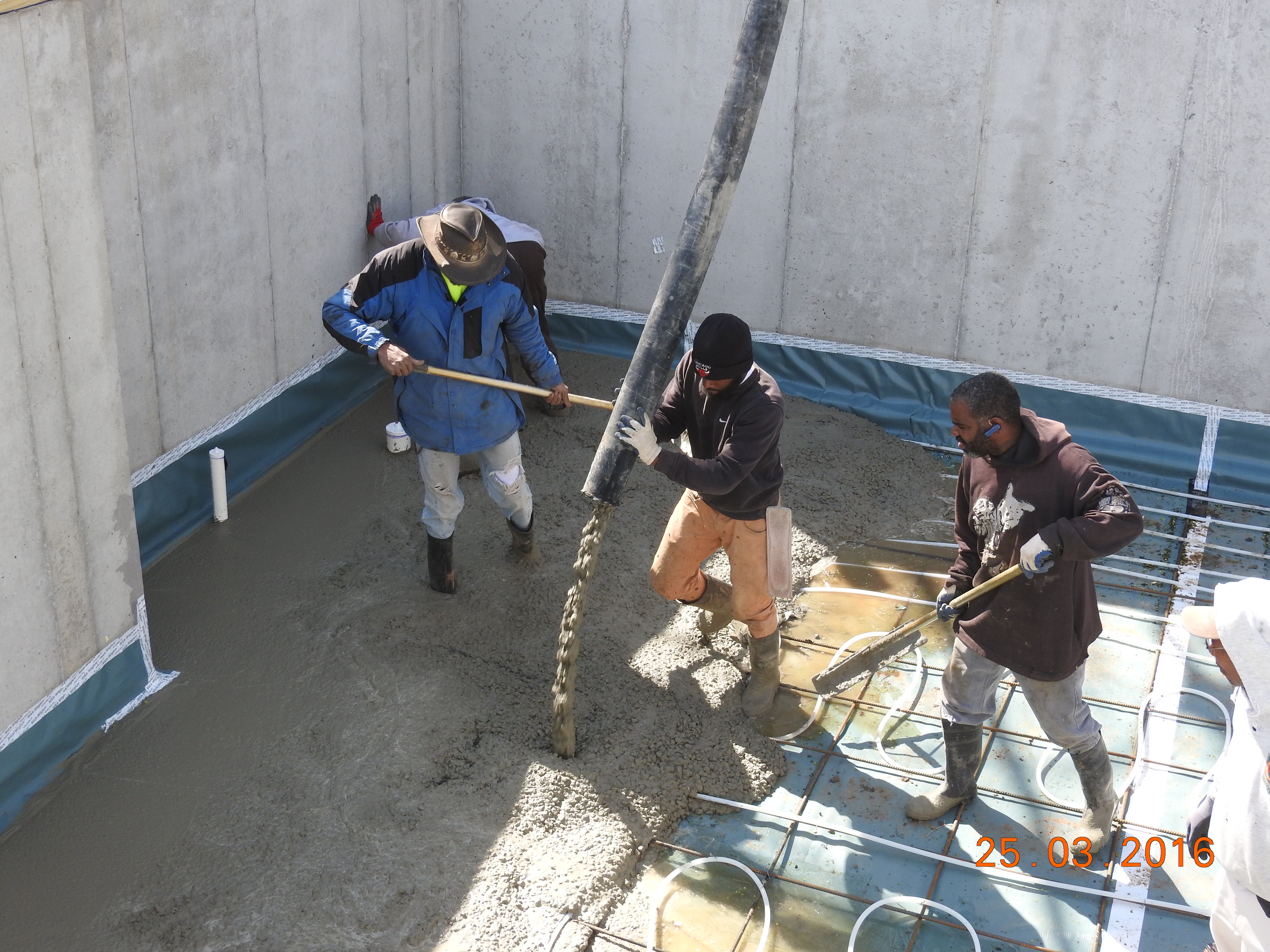

The slab is then poured and troweled.

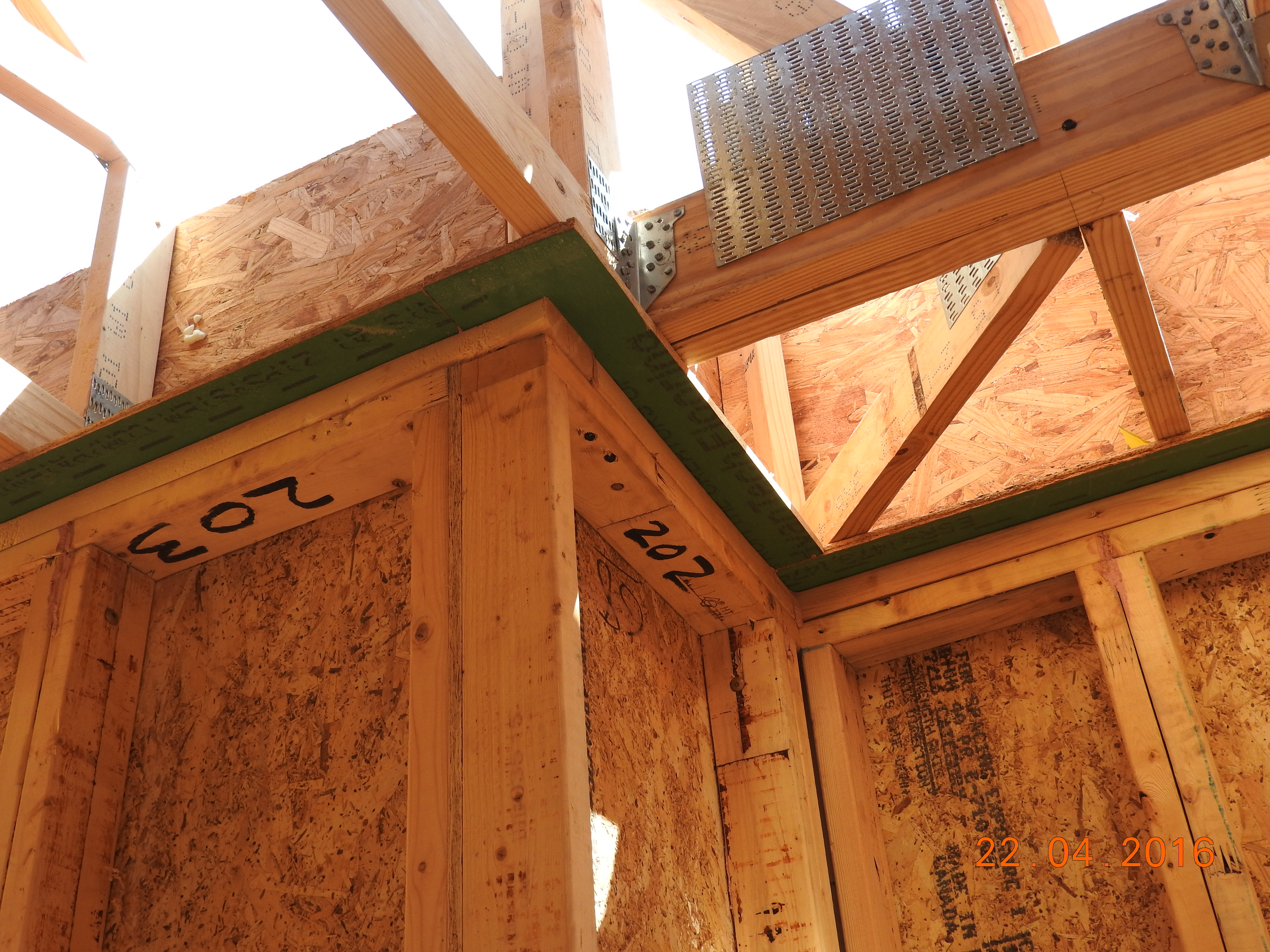

A piece of 7/16 inch Zip Wall panel is placed and sealed on top of the wall for the heel truss to rest on.
This panel allows for additional Zip Wall panels to be secured to the bottom of under the roof truss chords to provide a continuous and robust air barrier.

It is also important to note that any penetrations in the insulation for items such as plumbing are also sealed with spray foam. Where possible, providing anchorage to the foundation wall reduces the amount of movement at the penetration prolonging the life of the seal.
Another important design consideration is how to treat the slab edge as it abuts the foundation wall. In most residential construction the slab, footing and foundation wall all abut each other without a thermal break. In this case, 4 inches of insulation rated to 40 pounds per square inch was used to separate the slab and to ensure that it would not crush under thermal expansion and/or movement of the slab.
Once the foam was installed, a more robust 15 millimeter Vapor Barrier (6 millimeters is required by code) was installed over the insulation and sealed to the foundation wall with adhesive tape. All joints, seams, and punctures in the barrier were sealed with tape. Once this was completed, the rebar and radiant floor system were installed. The slab was then poured, troweled, and finished.

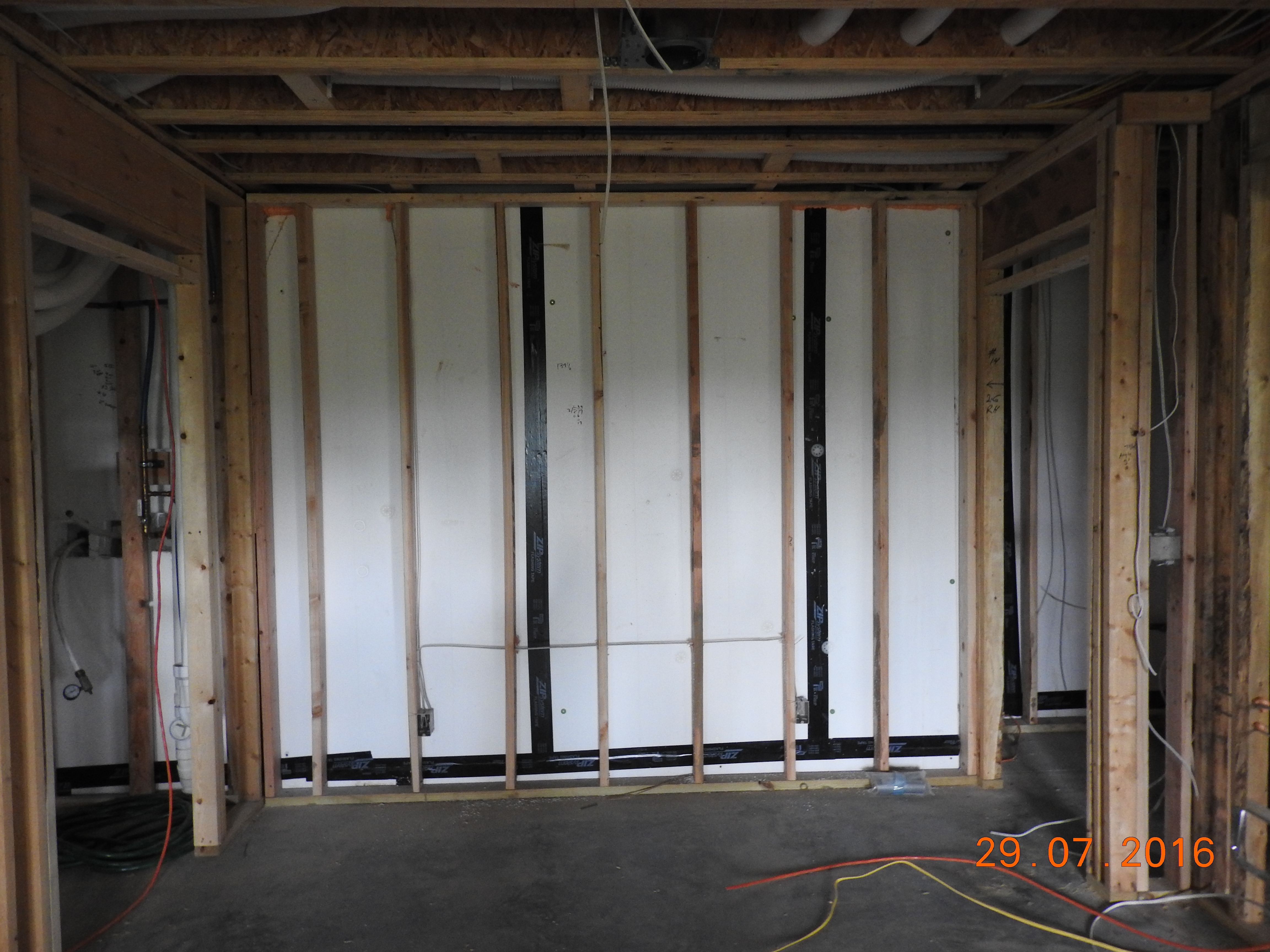

As the panel installation progresses, a key component is to seal each panel together and to the decking. This process starts with the base first where PROSOCO R-Guard Joint and Seam Filler is applied at the inner OSB air barrier layer. The sealant is then applied vertically up the adjacent panel allowing for a continuous seal of the OSB. Zip Liquid Seal, which is very similar to PROSOCO R-Guard FastFlash, is used in the manufacturing process to seal the two layers of OSB and insulation together to eliminate the risk of moisture infiltration.
Spray foam was then applied to the EPS to allow it to bond to the next panel, although this is not called out in the Build SMART Installation Manual. Each panel joint on the outsize Zip Panel was then taped using Zip Tape. Zip Wall also offers a fluid-applied sealing system similar to the R-Guard FastFlash used by Build SMART in the rough openings.

Finally, to compete the envelope, it should be noted that a piece of 7/16 inch Zip Wall panel was placed and sealed on top of the wall for the heel truss to rest on. This allows for additional Zip Wall panels to be secured to the bottom of under the roof truss chords to provide a continuous and robust air barrier. To reduce the amount of penetrations, a furred out finish ceiling will be provided to accommodate any ceiling light fixtures.
