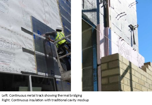

The day ended with Global Director of Building Sciences at Owens Corning, Dr. Achilles Karagiozis, talking about enclosure design from the perspective of hygrothermal analysis. He noted that building science deals with designing for both durability and human comfort. He also noted that we need to look at how to achieve zero net energy buildings as clients and owners are demanding enclosures that align with outcomes of high thermal comfort with reduced energy costs and increased durability. To achieve these goals, project teams must design with an understanding of how moisture accumulates in modern material assemblies and how our designs must avoid thermal bridging through the use of continuous insulation and air barriers.
