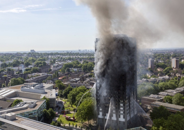

    The general consensus in the media is that the London fire catastrophe in the Grenfell Tower couldn't happen in the US because of our stricter fire codes which don't allow highly flammable insulation material on facades without fire retardents and certainly no high-rise building with a single exit stairway. While it is true that US standards are stricter on both of those counts, there remain troublesome aspects of the London fire that should give architects, engineers, and building managers involved in multi-family housing pause as they deal with egress and flame spread .
    Grenfell Tower fire, London
    There has been a slew of sometimes spectacular facade fires on highrises which may not have had the terrible death toll of the London fire, but certainly caused very hazardous conditions and large property damage. Those fires happened mostly abroad, but not always: The huge fire on the Marina Torch, Dubai, February 21, 2015, the fire on the Grozny-City Tower Hotel, Grozny, Chechnya, April 3, 2013, and the Tamweel Tower fire in  Dubai, November 18, 2012. There were also prominent facade fires caused by foam insulation in the US, both in casinos that were found to have used non code compliant construction.  (The Monte Carlo casino façade fire in Las Vegas, NV, in 2008 and the  the Water Club Tower fire at the Borgata Casino in Atlantic City, NJ, in 2007. Source).
    Overall, the IBC identifies each major category of combustible component in an exterior wall, and provides detailed limitations and allowances for each type. For each such combustible component, there are typically individual component requirements, such as ASTM E84 flame spread index limits and ASTM E1354 cone calorimeter heat release limits. Making compliance easier, each section also includes several exceptions and exemptions. For example, NFPA 285 compliance is exempted for combustible exterior cladding that is installed not higher than 40 feet above grade. (Source)
