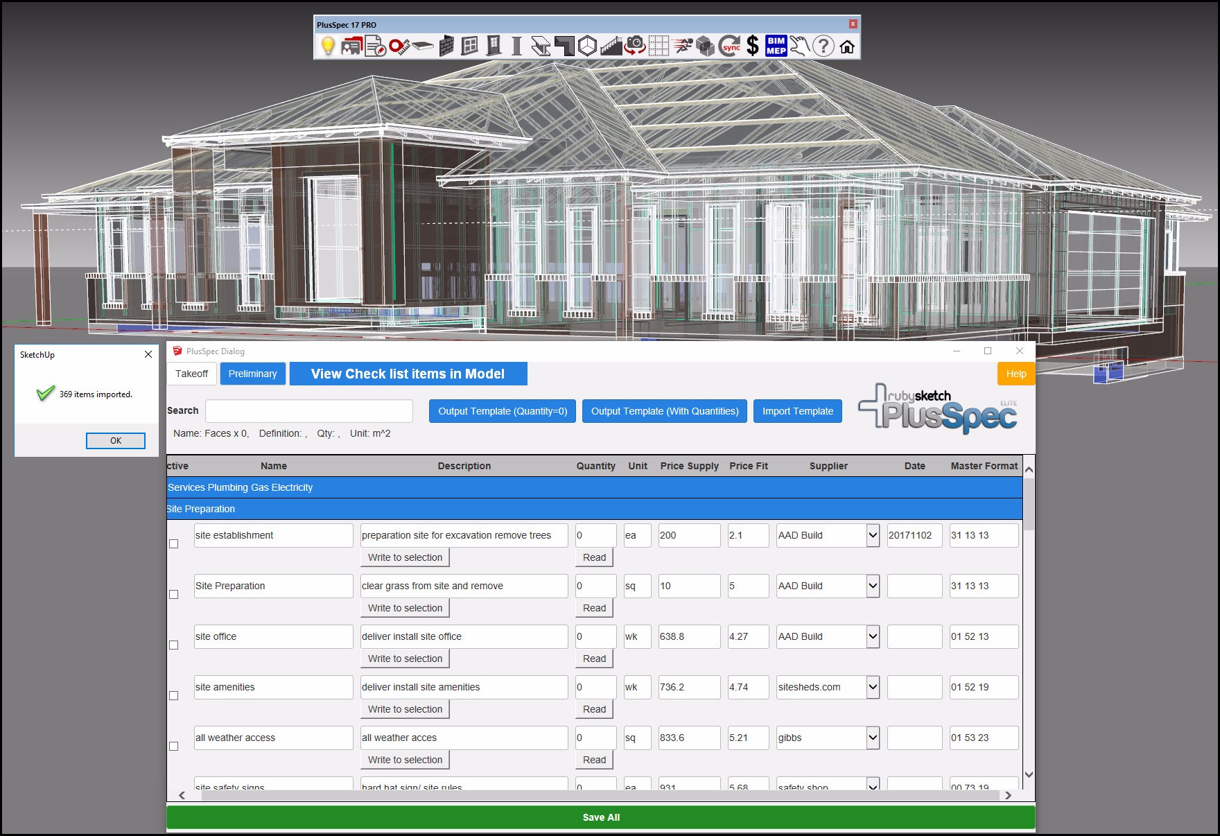

    No doubt we have all created checklists in many forms, I spent months creating dynamic spreadsheets with IF,<g data-gr-id="871" id="871" class="gr_ gr_871 gr-alert gr_gramm gr_disable_anim_appear Style replaceWithoutSep">&,</g><g data-gr-id="884" id="884" class="gr_ gr_884 gr-alert gr_gramm Style replaceWithoutSep"><g data-gr-id="871" id="871" class="gr_ gr_871 gr-alert gr_gramm gr_disable_anim_appear Style replaceWithoutSep">OR</g>,Vlookup</g> statements that automated checklist tasks according to project type using Visual Basic in Excel.  I am not sure anyone could create a generic spreadsheet that will be a one size fits all for design and construction businesses. In saying that starting with the basics that can be built upon would save a lot of us a lot of time initially.
    In my professional opinion, I think that excel sheets with basic line items are ineffective, once you start to automate these sheets, everything is reliant on <g class="gr_ gr_186 gr-alert gr_gramm gr_inline_cards gr_run_anim Style replaceWithoutSep" id="186" data-gr-id="186">IF,<g class="gr_ gr_192 gr-alert gr_gramm gr_inline_cards gr_run_anim Style replaceWithoutSep" id="192" data-gr-id="192">AND</g></g><g class="gr_ gr_192 gr-alert gr_gramm gr_inline_cards gr_disable_anim_appear Style replaceWithoutSep" id="192" data-gr-id="192">,OR</g>  which can easily be corrupted.
     Associating the checklist with the design is the key in my opinion as it reduces the likelihood of oversight. The majority of, if not all of the checklist information can be imported and associated with the BIM software I use in Sketchup. It can also be intuitive as staff can see what they are doing live instead of ticking boxes, which we all know is laborious.  Can you Imagine importing your checklists into your 3D model and selecting items and associating them with templates and geometry? This functionality makes a dreaded task an enjoyable one, one that is easy to check by superiors.
    I have a working version for my own company, feel free to PM me if you would like to find out more as it is not public. I believe that everything should/can be connected to the geometry and layout visually and that this method is a better way of eliminating mistakes while communicating downstream via a 3D model. Does anyone agree?
    This image shows an imported searchable  spreadsheet Check list with Master format
